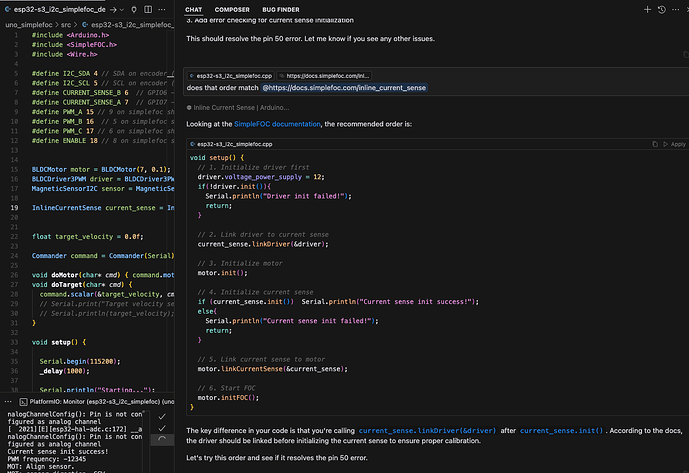

Cursor is an AI-powered VSCode fork so PlatformIO just works. I use it at work all day long (mainly python for machine learning) but it works great with Arduino code!
It’s helpful in debugging
