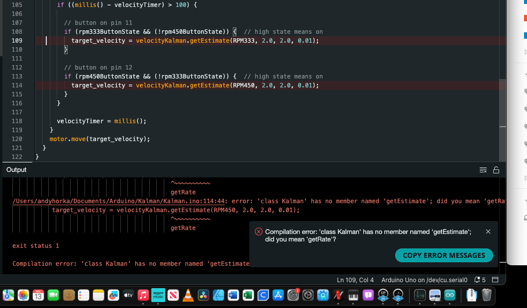

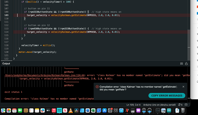

Finally got around to testing the code. The library I found was the Arduino Kalman Filter Library. Had to change the code for Kalman.n as opposed to HalmanFilter.h
All good until
if (rpm333ButtonState && (!rpm450ButtonState)) { // high state means on
target_velocity = velocityKalman.getEstimate(RPM333, 2.0, 2.0, 0.01);
Added screen shot with the error. Thanks for you patience, I am sure it will be something relatively simple.
Thank you. I have seen that, my issue is the member is not in the library. The library in the code cannot be addressed as written.
Are you sure? I thought you were using a generic kalman library you found because Valentine forgot to include the link to his. The class in that thread has a function getEstimate, so I think it should work.
You can see the error in the screen shot, so sadly no go for now.
