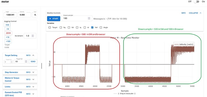

I wrote a little routine to stop my BLDC/Hallsensor/SmoothingSensor setup to stop from jittering when velocity = 0.

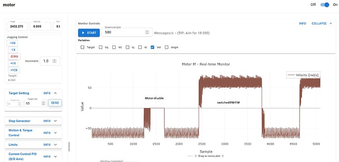

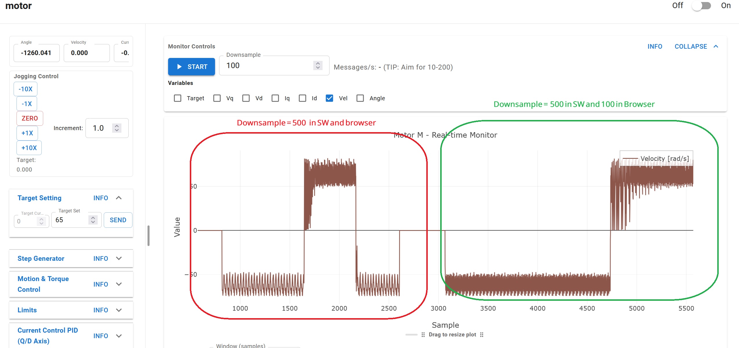

It worked so_so and needs PID fine tuning, but what I found more interesting is the difference between Reverse and Forward velocity.
I don’t think it’s related to my anti_jitter
Gave it another shot without anti_jitter. It now seems to be related to motor.monitor_downsample ?
