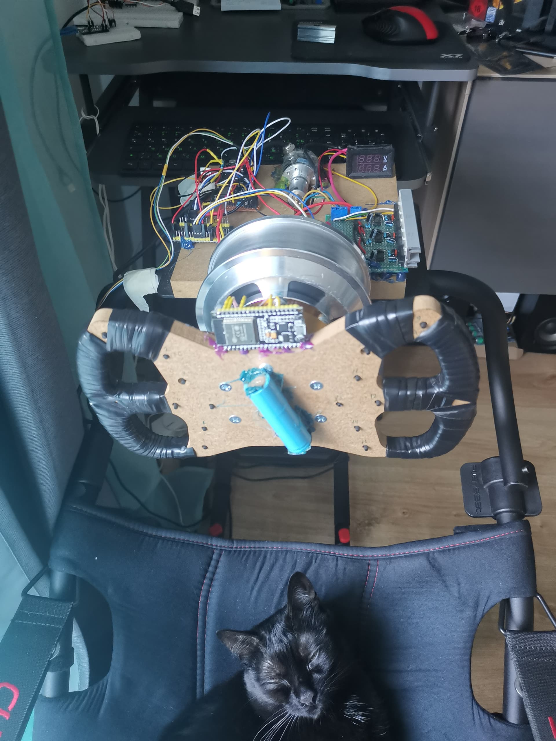

Good afternoon. In my project I use esp32 and the drivers of the ir2104 mosfets. I have two questions: can I invert the enable output signal? I use an analog input to control the motor. This all works well, but when the engine is standing, the lower shoulder mosfets are open, which causes difficulties when the engine rotates. Can you help me? I’m building a game steering wheel using a gyro scooter motor

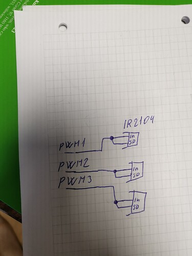

I think my ir2104 is faulty. They work only according to one scheme, where the pwm output is connected simultaneously to the IN and SD input. In other cases, the work does not happen. I tried to send an inverted signal to the SD input, but the engine does not work (((.
But when the SD level is low, the mosfets of the lower shoulders open. I probably need to look for other drivers.

Thank you, I tried your scheme today. Unfortunately, it doesn’t work that way. When the lower signal is on the SD, the lower mosfets are open. When the upper signal is on the SD, all mosfets are closed until the upper signal arrives at the IN input. It’s hard to explain. I will try to show in the diagram how they work for me. I read that on Ali Express they often sell with the wrong label. Maybe I have so

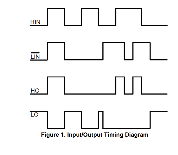

I’ve just looked at the ir2103 driver, maybe I’m wrong. But it seems to me that my drivers work that way. What does the line above the LIN entrance mean?
The line above a signal name indicates that it is “active low”, i.e. the state indicated by the signal name is achieved by pulling the signal to GND.
So a RESET signal with a bar, sometimes also written as RESET-bar or nRESET, means that the chip is reset by pulling this signal to GND.
The same signal without the bar would mean that the signal is “active-high”, i.e. that the reset happens when the signal line is pulled to VCC.
So in this diagram, the LIN-bar signal has the inverted meaning of the HIN (no bar) signal. HIN is active high, so the output HO is high when the input is high. LIN-bar is active low, so the output LO is high when LIN is low.
Additionally, this chip has some kind of interlocking protection, so LO cannot be high if HIN is high, and HO cannot be high when LIN-bar is low.
Thank you for such a detailed answer, I am very glad that this is still happening. I wanted to try to control these drivers using a 6 pwm. But if LIN’s input is inverted, then it turns out I can’t do it?
Not without changing the code of the library, or adding a logic level inverter to the output signal. Sorry about this!

I’m still waiting for other drivers. But today using the method of scientific poke. I have found a solution where I can turn off the lower mosfets while the engine is parked. This is most likely not correct, but it works
I hate to say it, but that circuit makes no sense to me.
For the IR2104, it is not intended for the shutdown to be driven by the PWM. This pin is intended to be used as the enable pin for the driver.
Note that SimpleFOC generally assumes the FETs of a half-bridge are always switched in a complementary state when the motor is enabled. The only exception is the dead-time insertion. So when the high-side FET is closed, the low-side FET is open.
If you want to switch both FETs off you have to call motor.disable().
