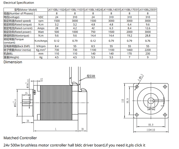

Do you think those ratings could be realistic, as a ebike front wheel (separate chain / custom fork maybe)?
It seems to have sensors installed.

Circumference of a bike wheels is about 2m. Max speed of 1500rpm - gives a top speed of 216km/h. This may suggest a 5:1 gear ratio might be useful to trade speed for torque.
Yeb ![]()
I do think it is alot to pay for AWG20 wires… I would rather see AWG14/16 and a fatter housing.

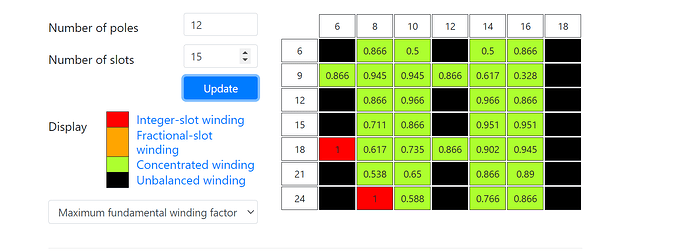

If we got the drawings, i can sketch up a mold for carbonfiber rotor with magnets glued in. There will need to be some sort of alignment with the stator on a closed bearing, perhaps two.
Then we choose magnets.
I think its best to keep the controller out of the housing on a separate cooling surface.
As seen in below image, with 12 poles, either 14 or 10 magnets give the same efficiency. 10 it is.
