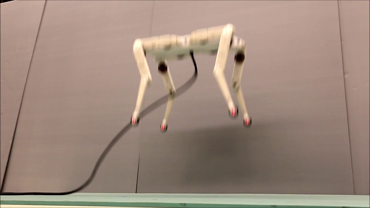

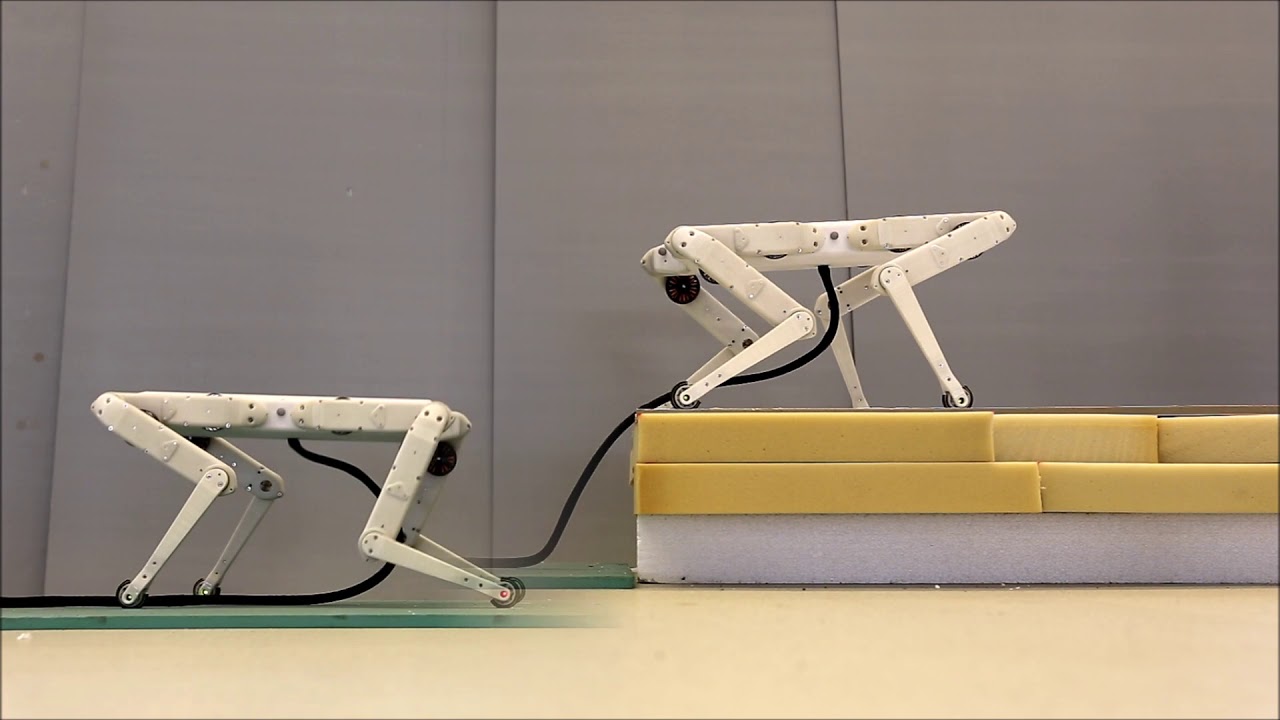

There is also a quadruped robot from Open Dynamic Robot Iniative:
Its open-source and very capable. :smiley:
The project is made by the guys from the French robotics laboratory LAAS-CNRS.
Hi, I’ve seen this one in the past, it’s one of my favourites. However theres so much info on the github and also I don’t really understand it unfortunately, not sure why though.
Here is a link to what has to be the lowest cost to produce cheetah-like robot. It is 3D printable and it is powerfull enough to jump taller than its own standing height.
All of the design files and software are open source. It is very well documented. See the link below
https://open-dynamic-robot-initiative.github.io

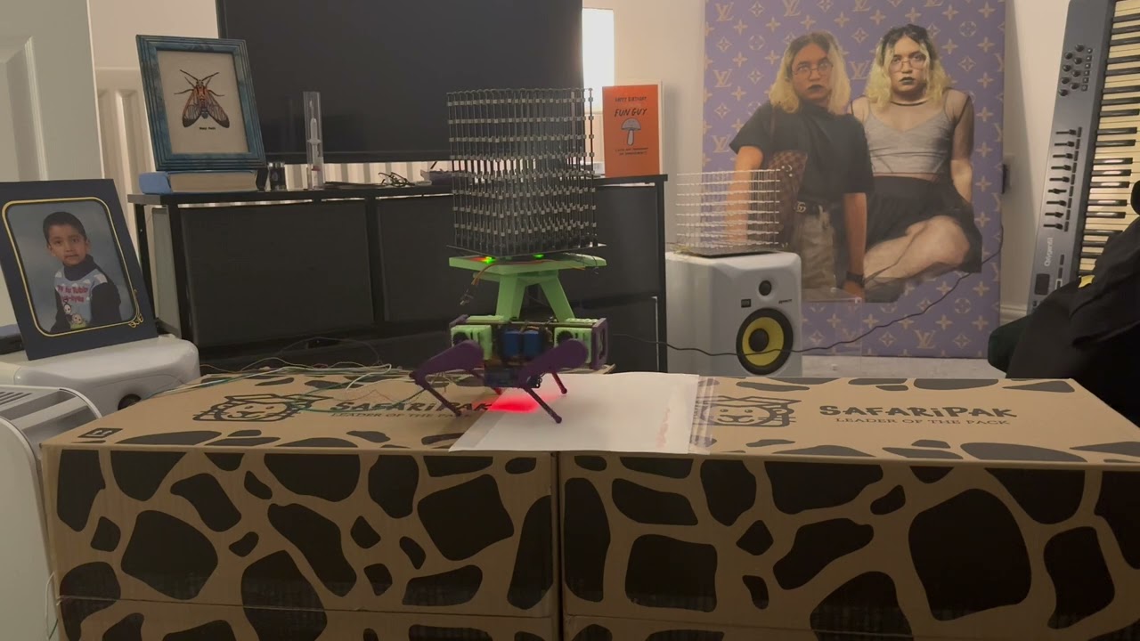

Sooo, I’ve made some progress with my Robot Fox myself haha. Check it out :grinning:
