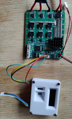

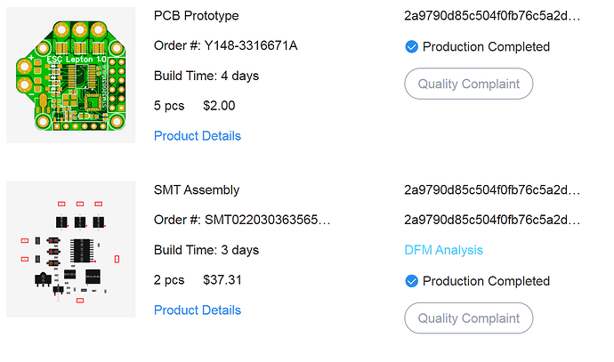

I’d like to at least prove the power stage combination that I selected works. I know the MCU and current sensing work, that picture above is another much more powerful driver board I designed for another project where I’ve tested everything quite thoroughly (unfortunately, very expensive and quite big board). However the driver and integrated dual-mosfet combo is untested. According to JLC it will be done in 5 days.
Production of core design completed, and shipped. Will post test results once received, then add current sensing and open the two designs: without current sensing and with current sensing.
