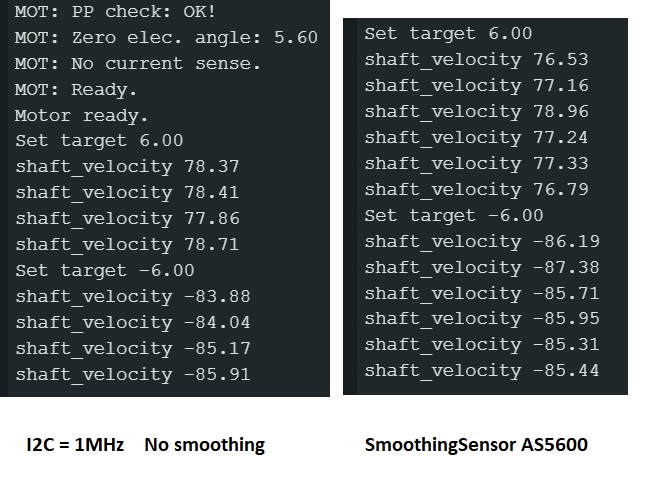

I made some tests with ESP32 and AS5600 I2C@1MHz. It works flawless, but it didn’t increase motor speed.
I also tested it in torque-mode with smoothingSensor and saw some differences:
It ran slightly slower in one direction, but faster in the other.
I guess, it can be corrected with phase_angle correction.
Ideally the smoothing shouldn’t make much difference in terms of speed.
This sounds exactly like a motor timing issue. That it goes faster in one direction than the other would be because the zero offset of the sensor is biassed in one direction. Thus the motor timing is by default slightly different in one direction than the other. Try adjusting the sensor zero offset by just setting it with a single line of code to slightly higher than whatever the program is currently using. If that makes the motor go faster then that’s it.

If smoothingSensor could compensate the sensor-hiccup it would make it run slightly faster, I thought.
