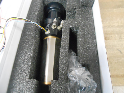

It’s still motor drive but rather different. I am looking for a VFD that can do 3000 hz and they are pretty uncommon. All they really do I think is output a sine wave, they ramp the frequency and voltage though. The b-g431b-esc1 board could update the motor.move() at 37.5 khz. If I could up that I might be able to just use one of these boards as a vfd for my low power spindle, it’s a PCB milling spindle that does up to 50,000 rpm. With these kinds of motors, the frequency is approximately proportional to RPM (there is some “slip”, unlike a synchronous DC motor, when the difference between the rpm and frequency grows the torque grows).
Bad idea? The spindle is only rated at 500 watts and I doubt I will use 200 most of the time. Gotta cut back somewhere, and it’s an intriguing new region to explore. There are a lot of spindles like this kicking around on ebay for $500 each.
oh wait I think the voltage is like 220 volts. Any idea for a power stage that can handle that that I could grab and use with a nucleo board?
