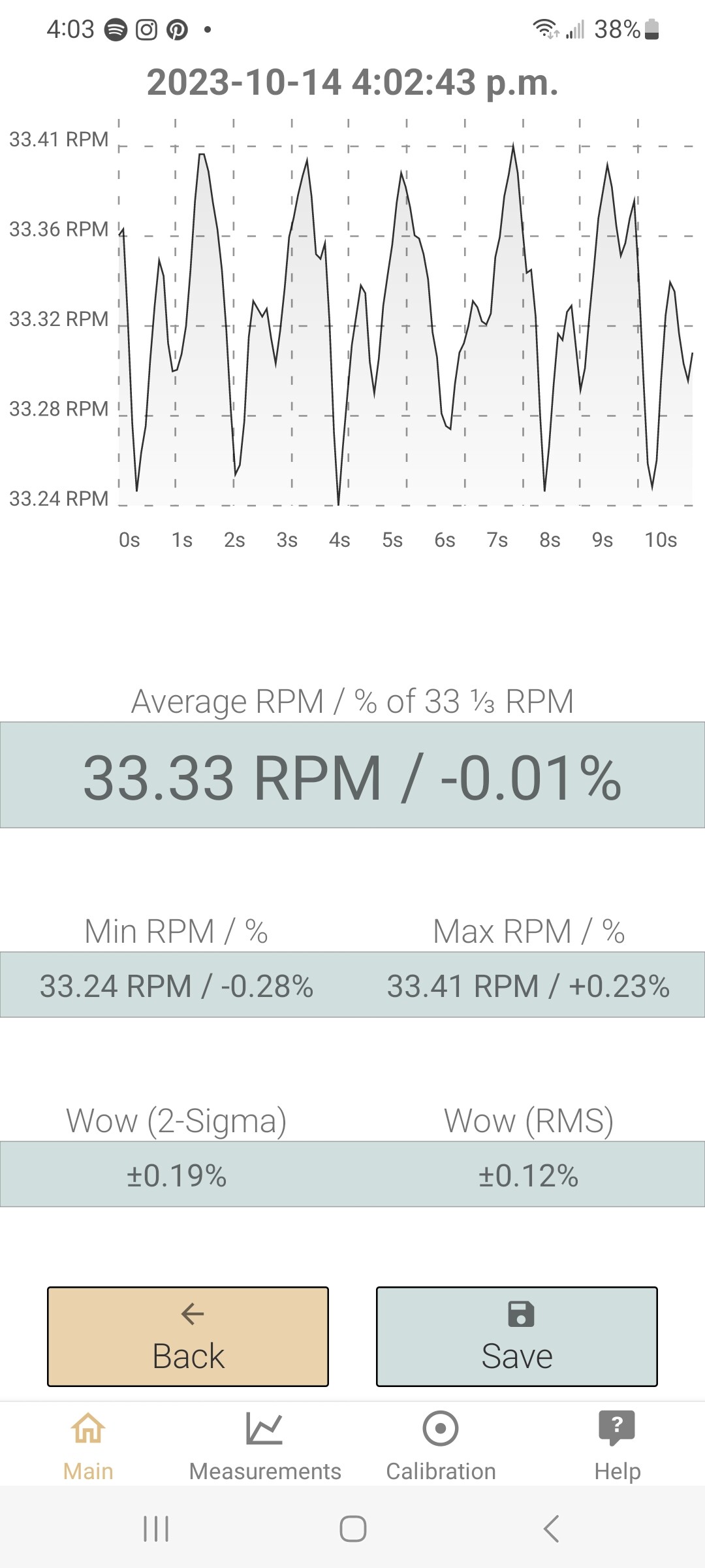

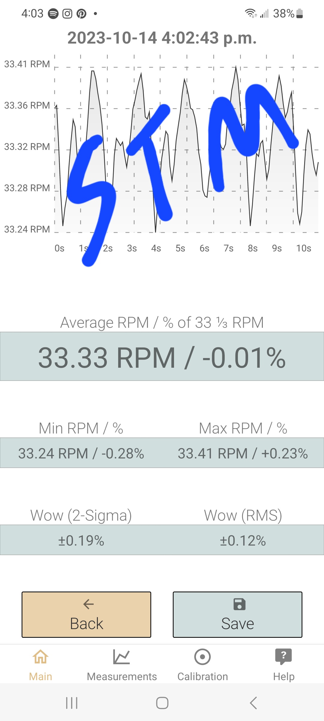

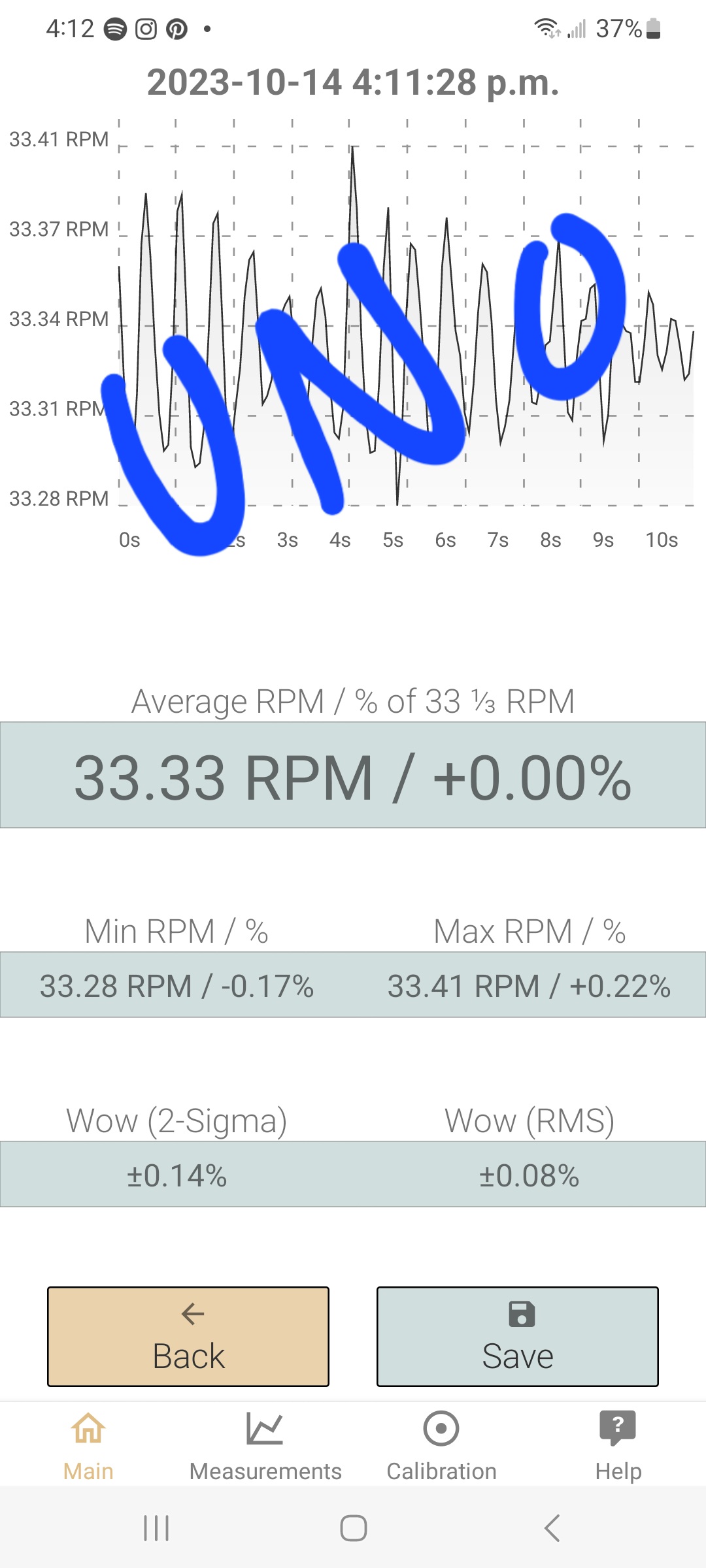

Yes, you are a genius. I had nested the line. Reflashed and all good. Just trying to get the wow down a bit but totally useable now.
So to conclude this adventure, I say a thousand thanks for all the help. So now there are two viable cards, the Uno and the Nucleo G474re for my turntable projects. The F401re cards are probably useable with an added crystal, but not sure if it’s worth the time.
