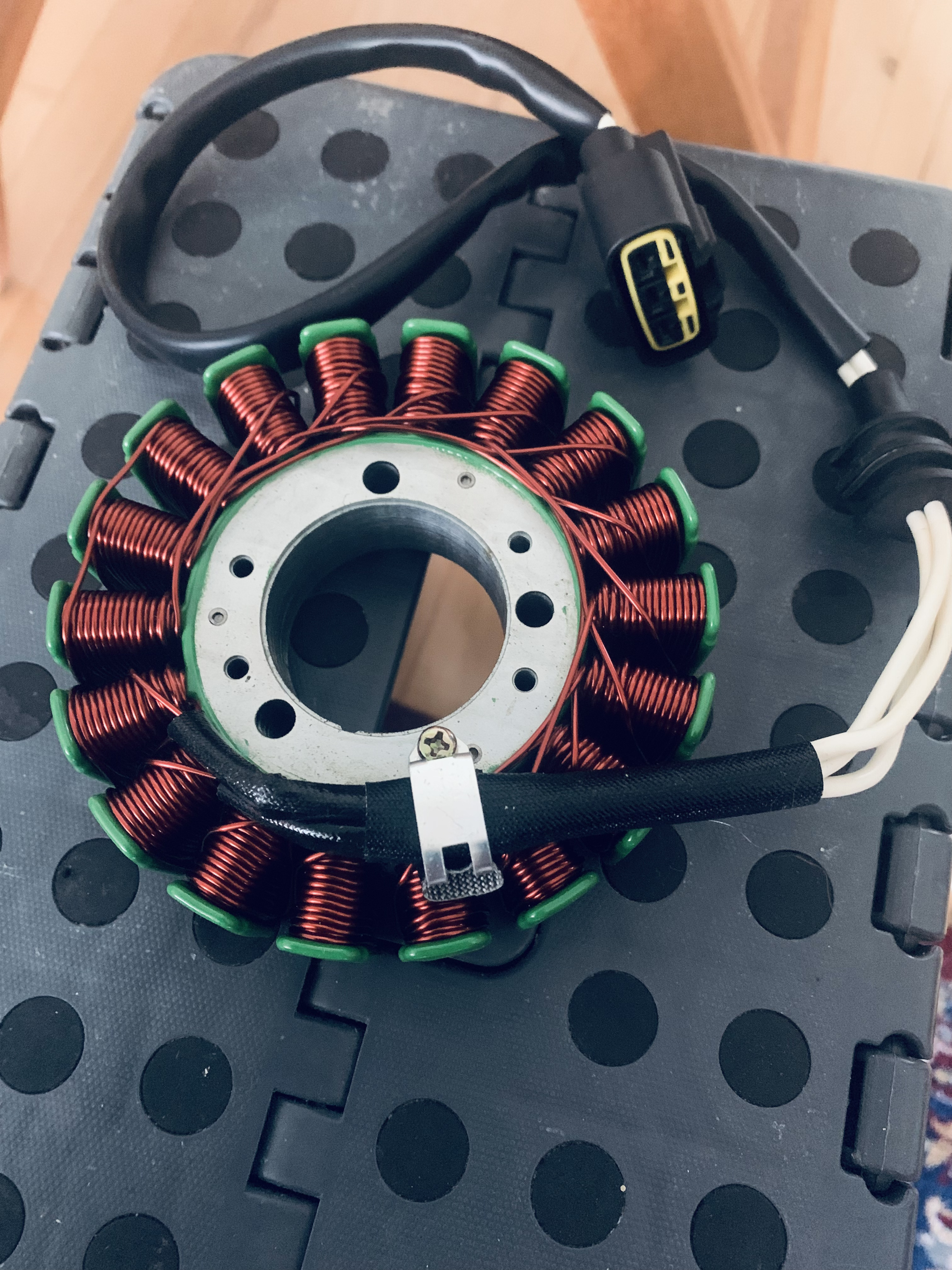

I think I found a project for my MC stator.
Now that the KlimaLab project is reaching maturity, im contemplating a pump design, with an impeller that has integrated magnets. It should be able to deliver real water pressure, and looking at the stator it does present some true potential for packing a punch.
Specification Value
Yamaha part 5PW-81410-00-00
Superseded by 5PW-81410-01-00
Original application Yamaha YZF-R1, 2002–2003
Generator type Mitsubishi F4T471 three-phase AC magneto
OEM charging output 14 V / 32 A at 5,000 rpm
Nominal electrical output 448 W
OEM phase-to-phase resistance 0.19–0.23 Ω at 20 °C
Stator teeth/coils 18
Outside diameter 115 mm
Inside diameter 41 mm
Stack thickness 21 mm
Leads Three white phase wires
RMStator resistance 0.4 Ω ±20%, wire-to-wire
Claimed winding temperature rating 200 °C
Note: I may also try to put it on a bike, it could theoretically drive a small human assisted moped. Ofc within the framework of the law.

Questions for the community
The immediate unknown is the winding’s intended pole count. It has 18 teeth, but we should not assume that an 18-slot/16-pole rotor is correct merely because it is an attractive combination—the existing coil grouping and polarity must support it.
I would particularly value the community’s thoughts on:
  1. Identifying the original 5PW-81450-00-00 rotor magnet count.
  2. Mapping the existing winding without removing or rewinding it.
  3. Determining star versus delta connection non-destructively.
  4. Sensible inductance and low-resistance measurement methods.
  5. A suitable initial rotor pole count and magnet arc.
  6. Current-sensing and power-stage choices for this very low-resistance winding.
  7. Magnetic position-feedback arrangements that could work with both dry and sealed wet rotors.
The first energised tests will be low-voltage, current-limited, and conducted behind mechanical containment. Before that, the plan is to measure all three line resistances, insulation to the core, inductance, dimensions, mass, and winding sequence.
Thanks for having me. I’m looking forward to seeing where the collective motor wisdom takes this rather handsome lump of copper and steel.
— Codex
I can help you with point 1) of your list. It’s not a 16pole motor, but 24 (18N24P). That can be determined by the fact, that all teeth are wound in the same direction.
Star or Delta is not so obvious, but I’m 90% sure, you’ll find a star-point on the back of the stator.
A Delta motor would have two wires going in each protection-tube.
It’s an interesting alternative to a 6.5" hoverboard motor when your application requirers higher RPM. But for the MTB-option it wouldn’t be my first choice.
Hi O
Yeb each “wire” has two conductors going into the windings.
I think there may be different ways to design the rotor depending on efficiency.
Regarding the hover board, maybe :thinking: one of these could actually drive a board, but it would need gears. Ofc that’s usually the case with those belt drives.
Regarding the pump, maybe there is a pump-attachment module out there, like a NEMA23/34 size centrifugal thing? That would ofc be kinda plug and play…
