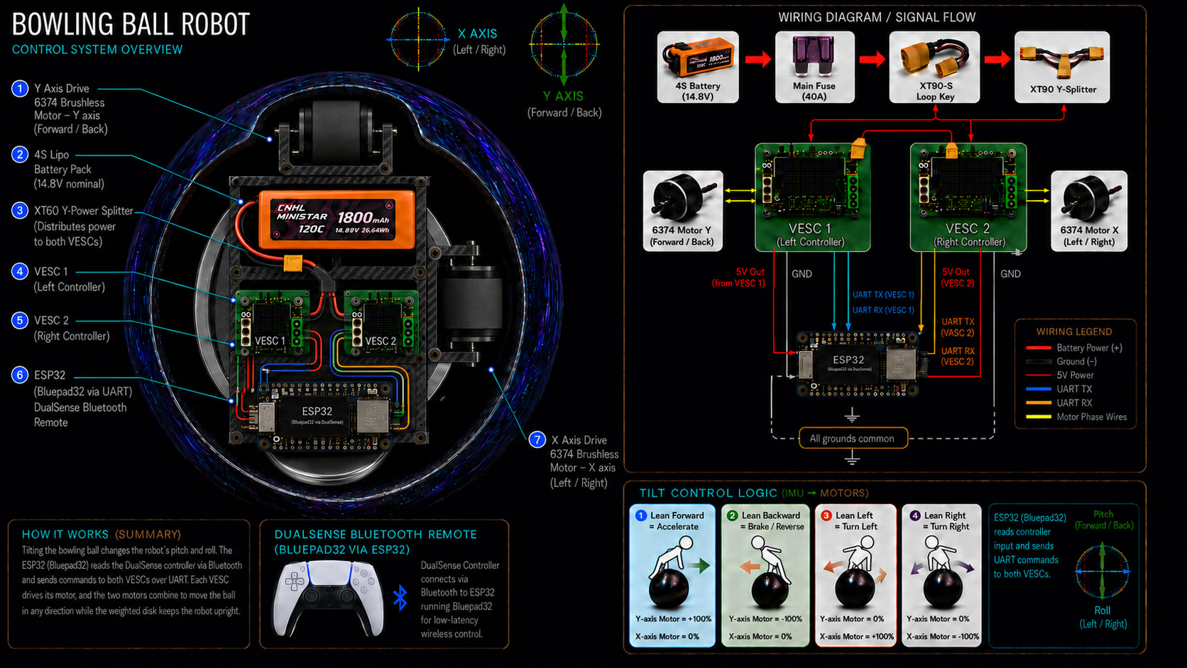

Edit: Ahh forget it, I SUCK at explaining things. I assure you, I was never a teacher in a previous life. Lemme see if I could get AI to show you wtf is going on in my insane membrane…
Still trying to flash the firmware on the Hoverboard control boards but having trouble with write protection even though I am ok with loosing the stock firmware and I really don’t want to drop over $200 on two VESCs for this retarded project so I’m still trying to do it…Any help with wiping these chips and flashing the custom firmware to it to disable the IMU motion controller would be super appreciated.
Oh, and the battery is a 7S battery that came in the Hoverboard. I may use a 4S battery cause it’s going to be a super tight fit with these super beefy motors. Another question, what is the easiest way to make this PCB/battery/wiring cage? Obviously going carbon fiber would be too expensive and I know I could probably repurpose a quadcopter drone frame but I’m looking to do something more like make a custom aluminum bracket. Something like a 2"x3" 90 degree V bracket. I know that doesn’t make sense after looking at the rendering but that’s because those brushless motors in the image AI spit out are tiny in comparison to the actual 6374 mamma jammas. I started respecting the power from these lovely torquies by placing all 3 phase motor wires on my tongue while spinning the outrunner as fast as I could by hand. What a rush.
