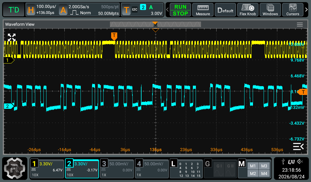

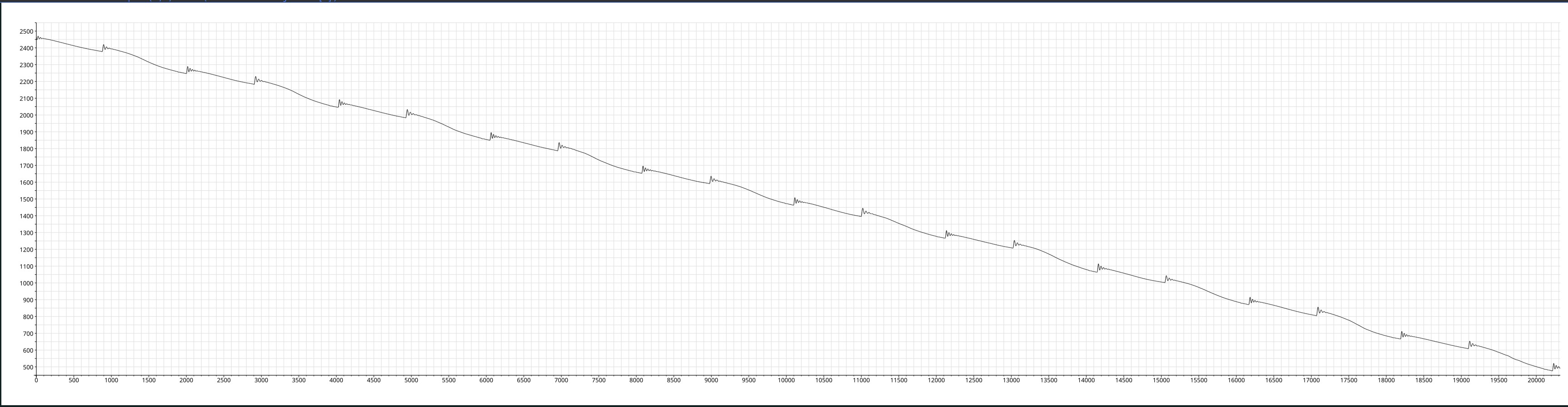

So I thought that maybe some noise on the I2C lines would create some jerkiness. So I hooked up the logic analyzer, and after some data transformation this is how the rotary encoder information decoded from raw I2C looks like:
We see the jerks, but the output correlates directly with what I’m observing - I don’t see any bitflips/random results. So I’m confident in the I2C readings.
As I’m looking at the oscilloscope in parallel I see the reading of the I2C data is incessant. No gaps. Is that expected?

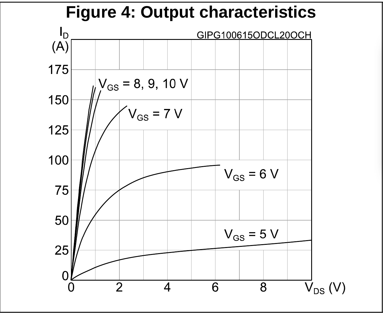

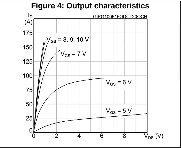

So whilst playing around with the device to see if I can dig deeper into the current sensing setup I discovered something that leaves me baffled. I’ve written a custom program that just turns one phase high, and the two others to ground. Then I put a 470O resistor between the phases to see the current flow, and measured that. Running the system at 10V I’d expect ~20mA of current. However I saw 14, and eventually discovered that the voltage between the phases sits at ~7.5-8V.
The gate drivers have the full 10V at their H/L outputs, and according to the datasheet (see below) and my limited understanding of these things the mosfet should be switched fully on.
I’ve tested this with several units to see if my attempts burned one or some such - they all showed the same behavior. Any suggestions as to what could be happening here?
You can use driver.setPwm(pwmA, pwmB, pwmC); to test your current setup.
The diagram show the required gate-source voltage ( not gate-GND) , which is problematic for the high-side FETs.
